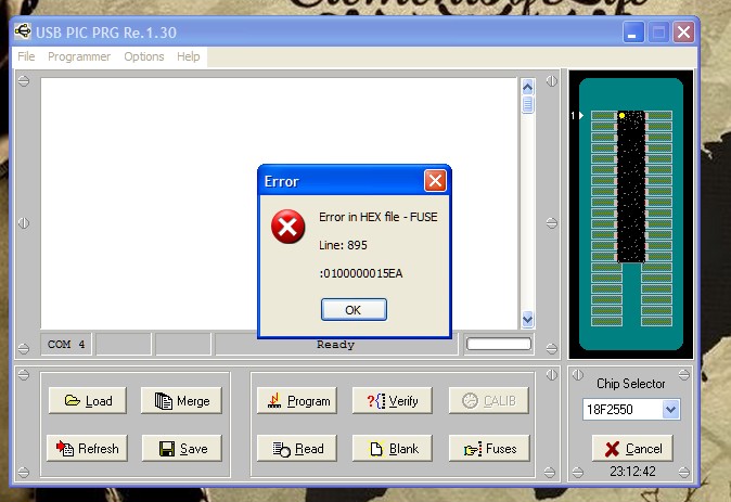

When load a hex file to program a PIC18F2550 is get following problem.
78.71 KB
So i can't program the hex into the pic afther the error message the hex is not loaded ..
What could i do about it ?

it's not corrupt , if i load it with Winpic or PicPGM is' load without problems , problem is those programs don't work with the usb programmer .. i have to use USB PIC PROG ....

The file fomat is incompatible on fuse section.
Use WinPIC800 read the file and then save as into second hex file. Use USB PIC Prog to open the second file.
Check all you fuse values are correct before write into the chip.
