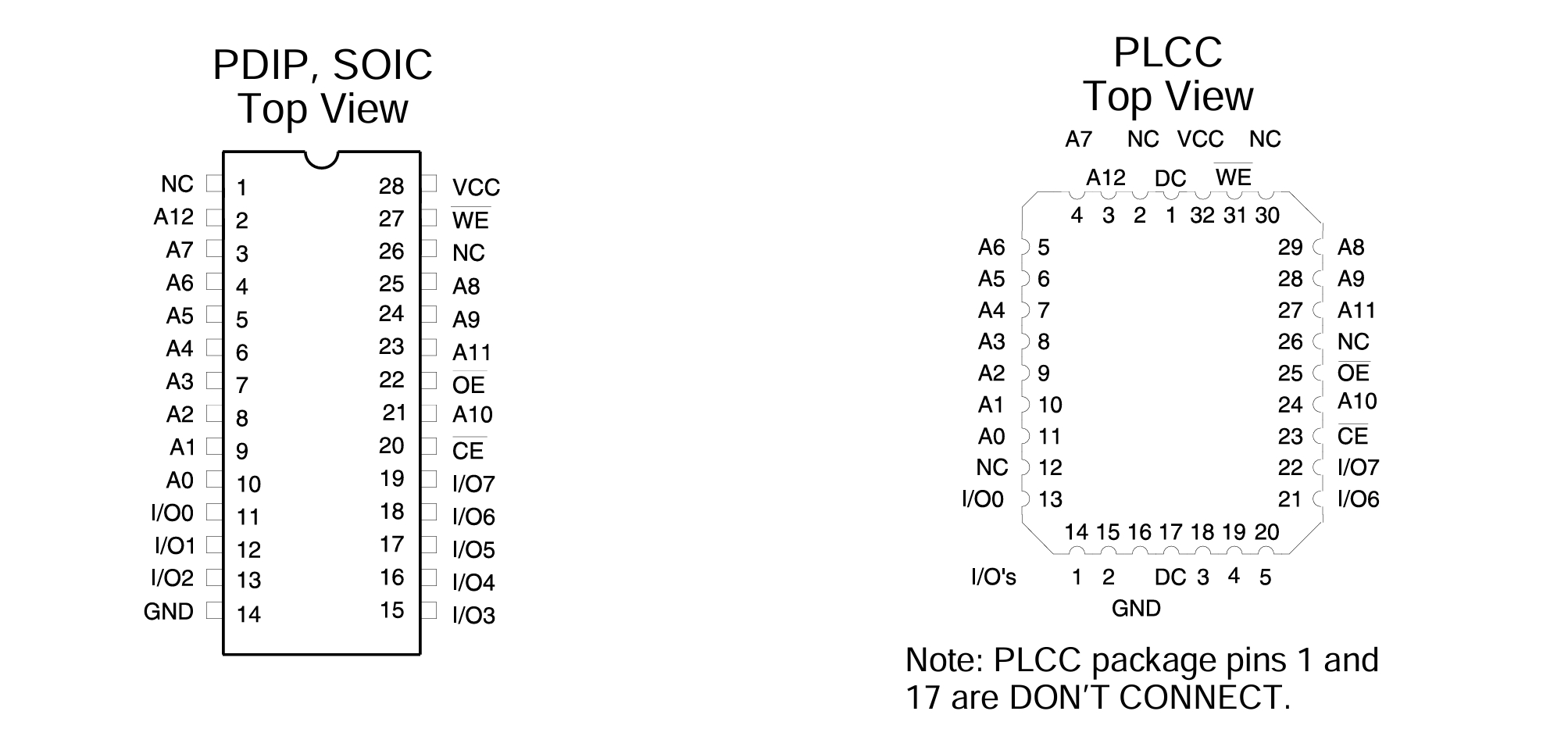

Use the datasheet.

Thank you anniel -- this is my first experience with GQ-4X4 (I have owned since new 2015 but never used!)
---> Is it the case that Pin 1..32 of PLCC-32 package would use 32 pins of GQ-4X4 DIP40 socket aligned with bottom(pins 19,20) of DIP40 socket, Pins 1..4 of GQ-4X4 DIP40 socket not occupied, and Pins 37..40 of GQ-4X4 DIP40 socket not occupied, so that:
? Pin 1 of PLCC-32 package corresponds to Pin 5 of DIP40
? Pin 16 of PLCC32 corresponds to Pin 20 of DIP40
? Pin 17 of PLCC32 corresponds to Pin 21 of DIP40
? Pin 32 of PLCC32 corresponds to 36 of DIP40
Is there any exception to pin mapping of ADP006 or ADP029 to this simple mapping? As there is no documentation of ADP006 or ADP029, I am not certain if pin numbering follows exactly, or if there is some exception.
Thank you again anniel for your advice!
Dave

Try following this for pin order keeping it to the bottom of the ZIF.

My solution was very similar to your new message - I connected the EEPROM module as if it were a DIP package version of the same device, that worked as expected. Before, I did not know that a DIP version of this device existed, because datasheet only described SMD packages, but different search yielded same information as your diagram sent here, and I could then configure for DIP version of the device on the programmer software.
