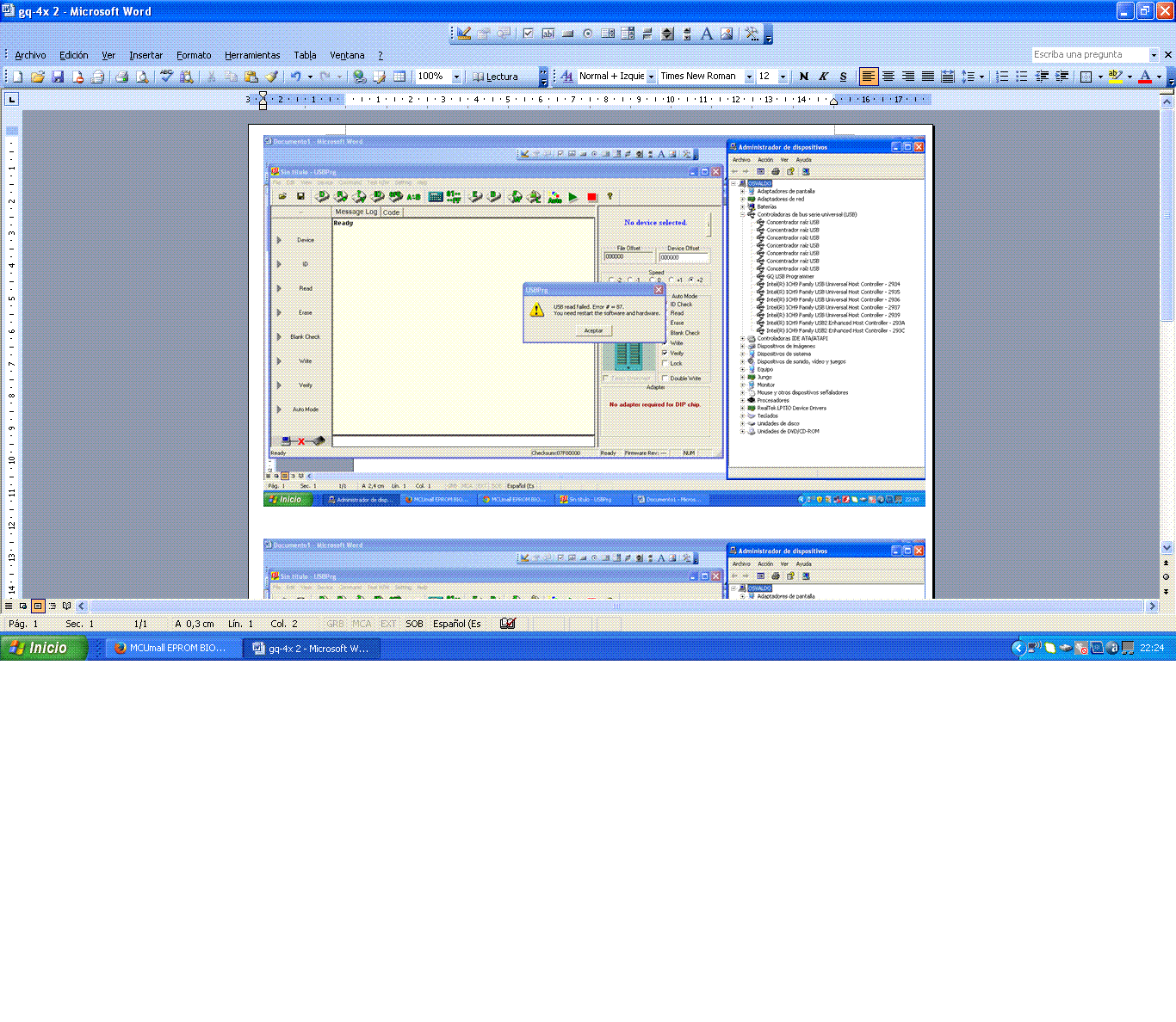

Already tried cable 3 very good warm and misto do you send mail the serial programmer
It may be corrupt some component you can send me the list of tp for diagnosis programmer to know that is damaged due
ZLM Posted - 02/07/2014 : 14:34:43
Check the USB cable. Use another working good USB cable and see if it works.
osvaldo Posted - 02/06/2014 : 17:43:25
140.83 KB
143.51 KB
See what you say is an2131qs replace the other as well and update the developer with the new ic
osvaldo Posted - 02/06/2014 : 17:39:09
143.73 KB
osvaldo Posted - 02/06/2014 : 17:37:45
143.67 KB
