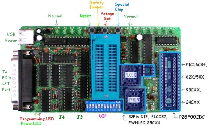

How can this model be powered externally to program? The 27c512 chip requires 12.5 volts for a successful - reliable burn. I obtained a 13.0 volt regulated 800 milliamp power supply. The instructions that came with this burner do not show how to power it externally to get a strong voltage. (15 volts will likely damage the chip) I am uploading a picture of the burner I have from the instruction guide.

Vpp was low. 11.7 volts. HOWEVER, I got it to work by "hard setting" the IRQ in the laptop BIOS and using EPP mode instead of "normal" which is "bi-directional" which I also guess is ECP. I also made sure the port polling "legacy polling" was OFF in the Device manager LPT1 port properties. Before setting the IRQ I got "zero" voltage and erratic program mode led light operation on the board. After "hard setting" the IRQ to port 0378, it programmed and verified OK
