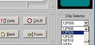

yes, I would normaly do that but the 12F509 is not on the list, I only can see the 12C509
Posted - 09/02/2008 : 16:38:15
It is there.
See:
[br][size=1] 12.72 KB[/size=1]
