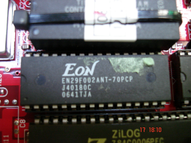

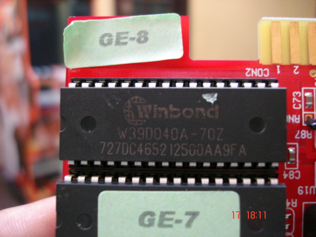

Hello,
I need to buy a programmer for these devices:
EN29F002ANT
W39D040A-70Z
I found that EasyPro90B apparently program the first
EON device, but can't found any programmer for the
second Winbond device.
Here are the photos of devices:
h**p://www.mcumall.com/forum/uploaded/Fenix/200911722325_EN29F002ANT.JPG
h**p://www.mcumall.com/forum/uploaded/Fenix/20091172240_W39D040A-70Z.JPG
I want to buy a Willem True USB programmer but apparently
can't program any of this devices...
Please help me to choose a programmer to work with this devices.
Thank you very much in advance!

buy old LPT Willem programmer
no problem with those devices

The True USB Programmer is able to support both chips.
The EN29F002ANT is listed as EN29F002NT. They are the same chip with different revision only.
The W39D040A is not there but it can be added. The W39D040A seems not a marketed chip, so no programmer have this chip in the supported list. But True-USB can add this in.

I have found this reffer links for Winbond device:
h**p://www.winbond-usa.com/products/winbond_products/pdfs/Memory/scriptPNMNV01.pdf
h**p://www.nuhorizons.com/ProductChange/winbond/Z200-PCN-W4200710-01B.pdf
In first link, Windbond says what programmers support each Winbond
device of that series and in the second link, appear the use for this
device: Parallel Flash Product List, W39D040A-70Z 4Mb ISA, P-DIP, for DVD player market...
The photo of Winbond device that I posted, is from a motherboard of
new Taiwan-China game machine like "cherry master", not a DVD player.
Thank you very much backbiter17, can you please add some link to specific Lpt McuMall programmer or/scriptnd device list for me?
And ZLM, thanks, can you confirm if an old Willem Lpt programmer
will work, or if better to me buy a True USB Programmer, I like
True-USB PRO GQ-4X Willem option, but what can I do to add this device
to a programmer supported list?

All LPT programmer supported flash devices are supported on GQ-4X and more.
Add a chip in to GQ-4X normally is based on the chip datasheet. If there are no datasheet for W39D040A, then we can try other similar chips, such as W29C020 or AT29C040. From there to find out the working algorithm for it.
