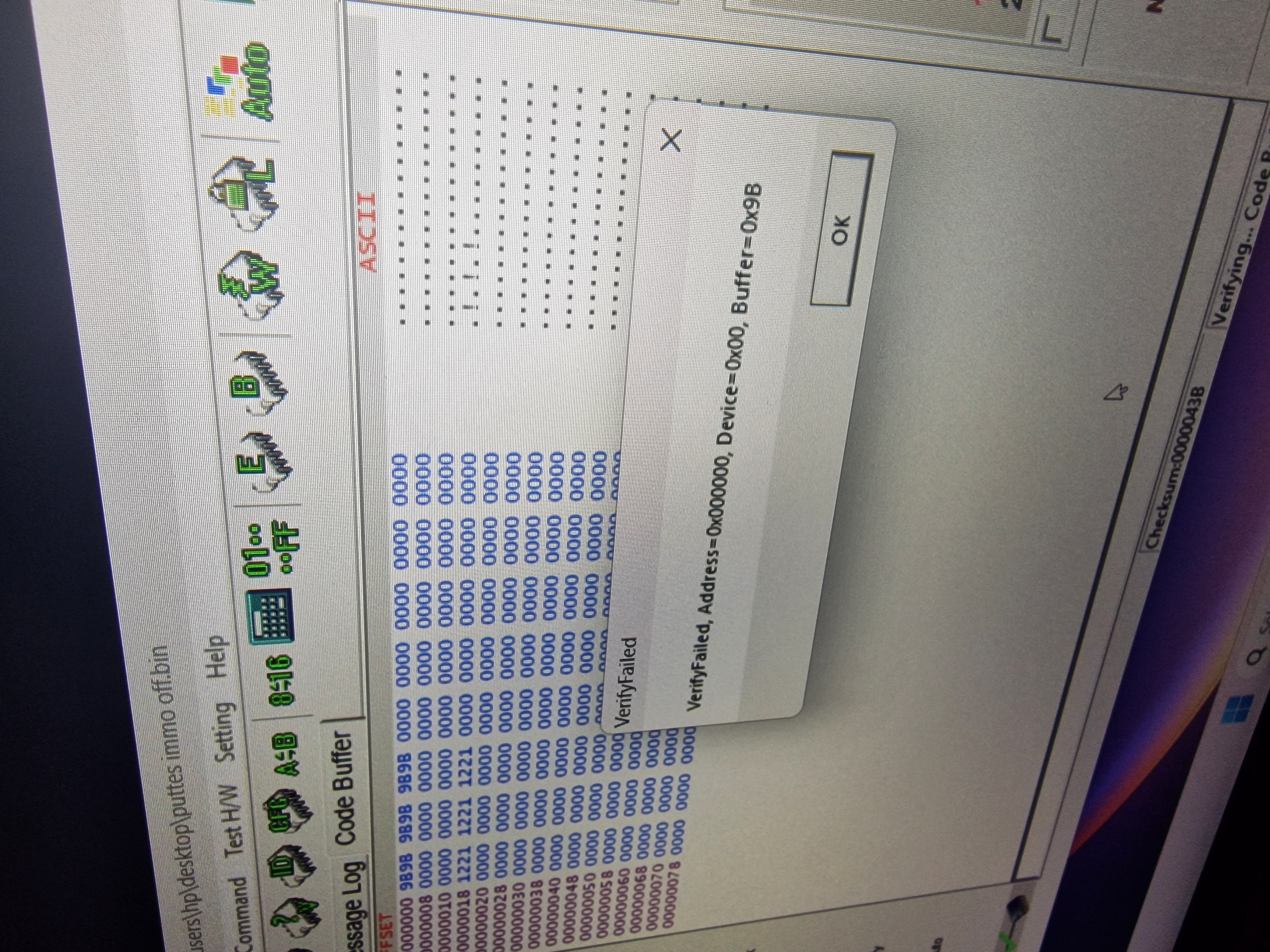

Tested with the GQ-4x4 now. Get verify fail on this one too. What am I doing wrong???
Have tested two blank eeproms and two from ecus. Have also tried many different 93c56 versions in the device menu. Tested with different speeds.
And also tested with a solder adapter, clip adapter and a adapter thst reminds of adp-004 which was included from the t48.
Please give me some hope. 3 months on this stupid toyota now and can't get anything to work

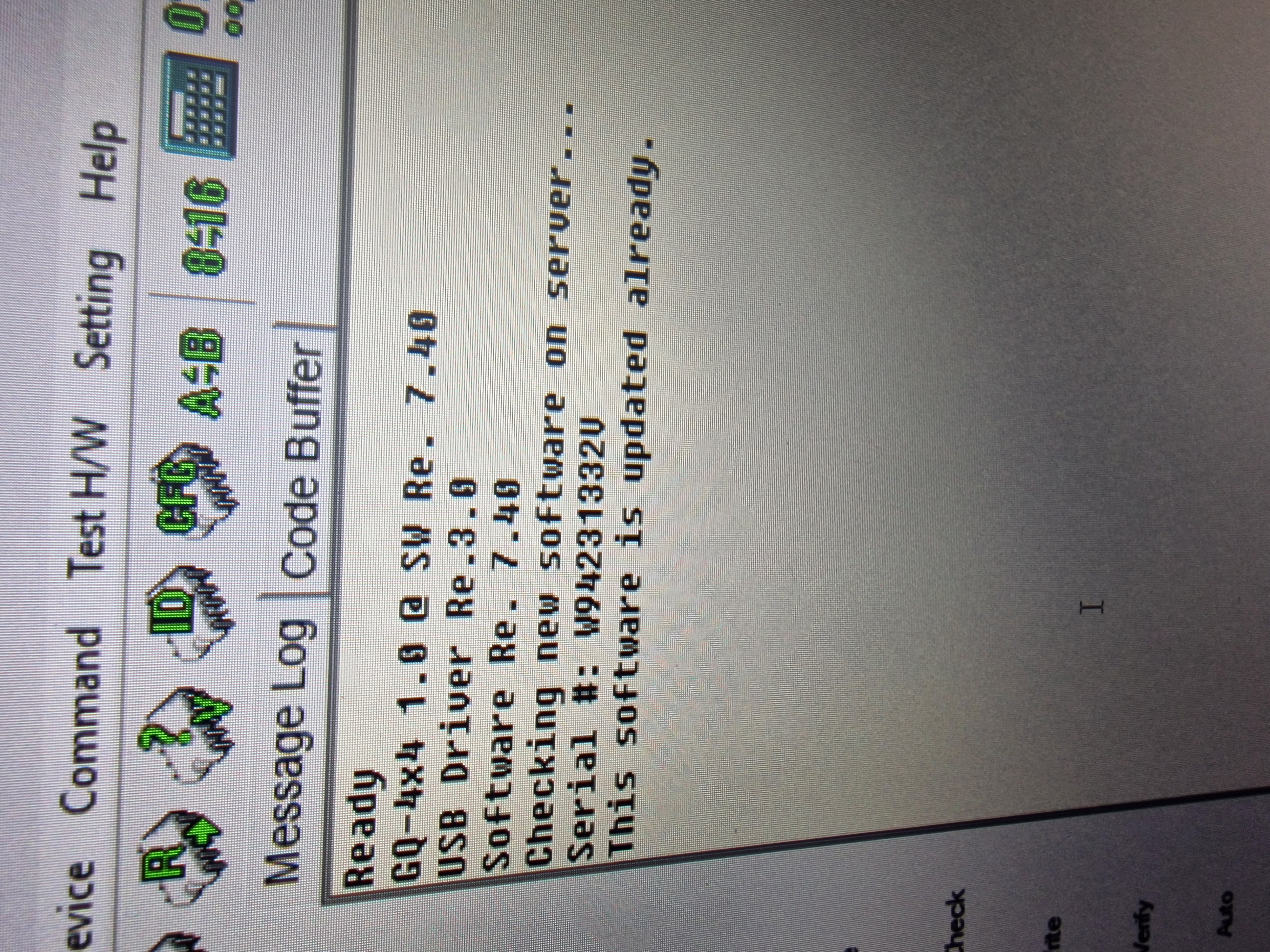

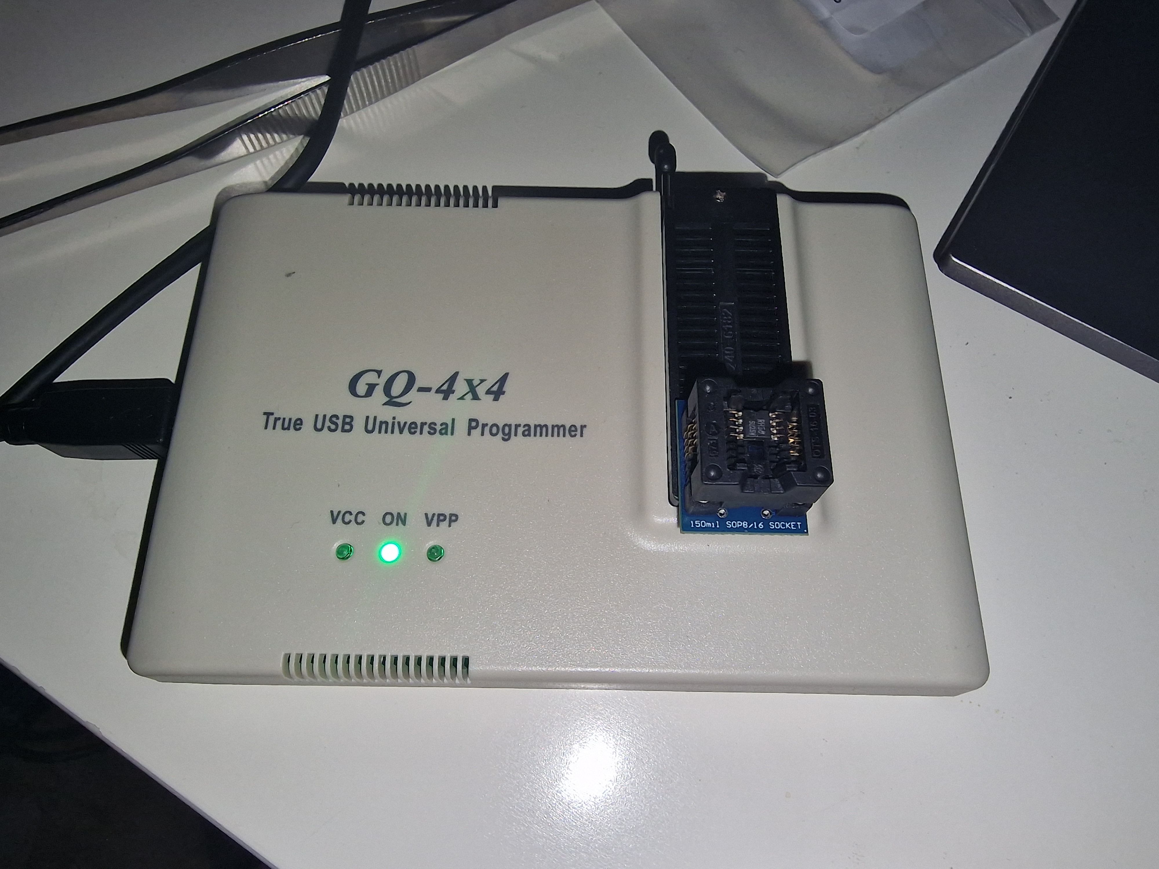

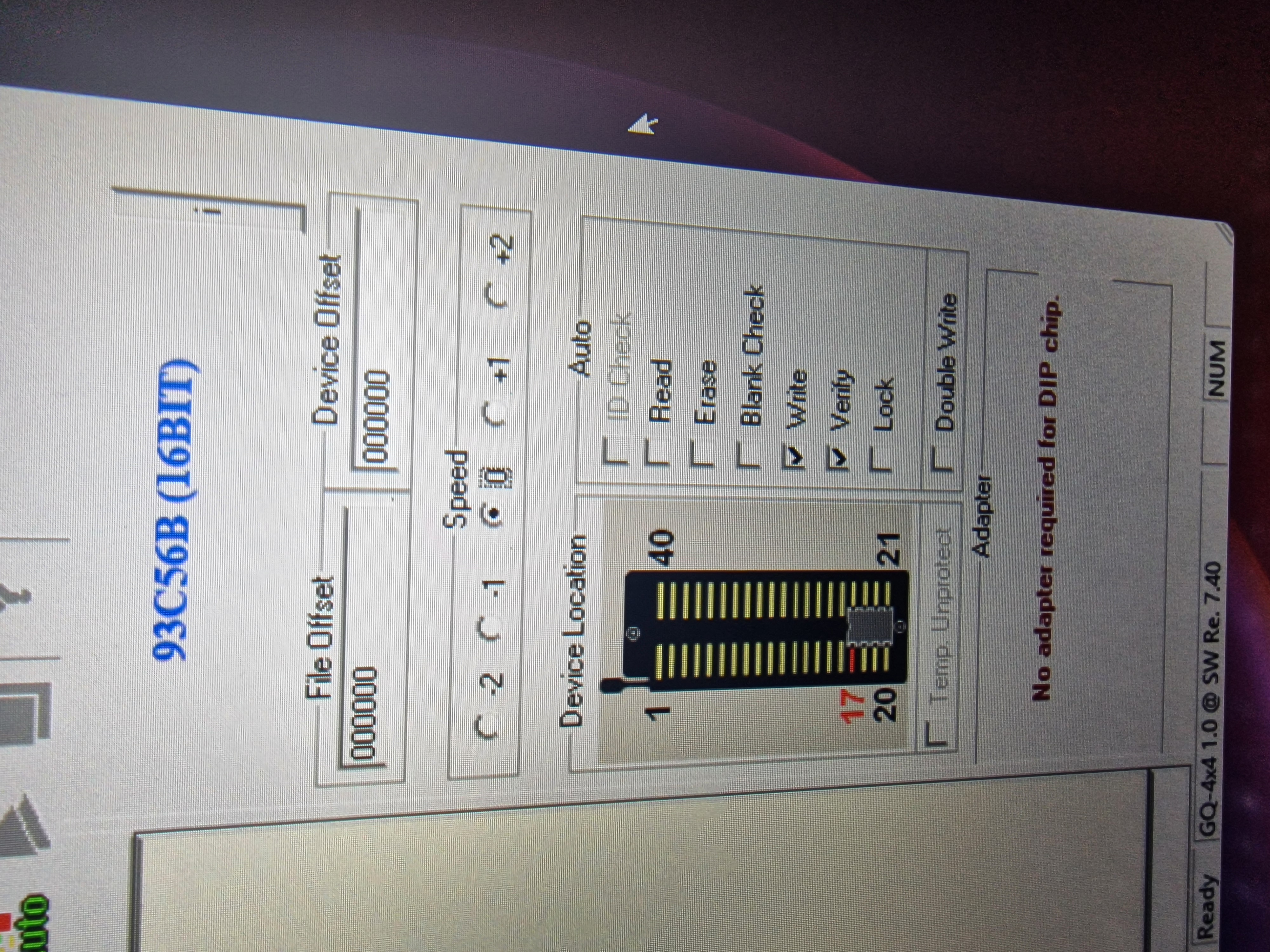

Please post a picture of your setup.
Bamse82
13 Posts
Posted - 04/14/2026 :  10:40:34  Show Profile  Reply with Quote

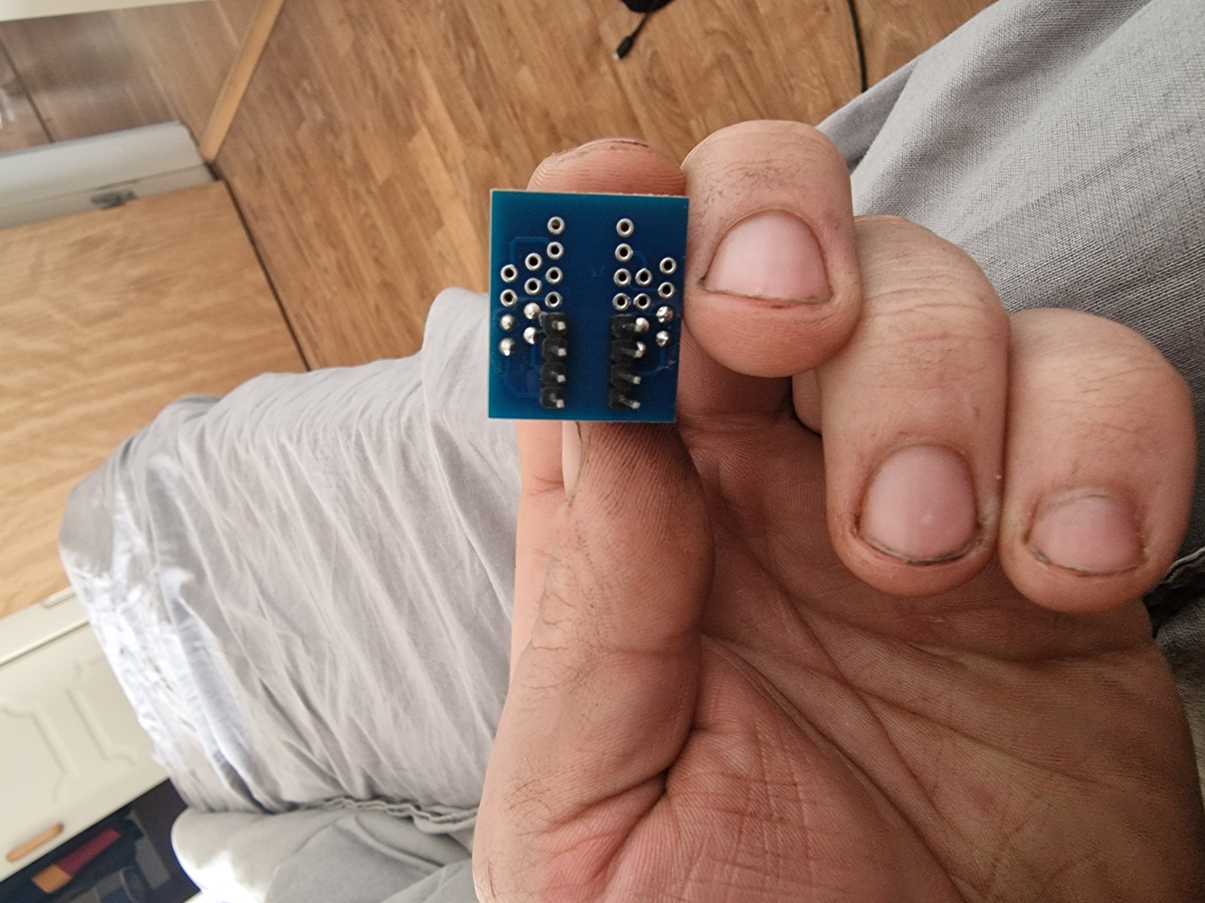

No i'm not. After erase the same data still appears. I thought if the t48 adapters has different pinouts? Because i'm out of ideas now. Seems that other users have sucessfully read/write those eeproms with both programmers.
Is your adapter a straight through?

SOLVED!!! Got a tip from a member on digital-kaos. I disconnected pin 6 and 7 from the adapter. Don't know why I needed it. Because other folks had done it 100% earlier. Well now we going to test the immo off. Thanks for your patience anniel!
