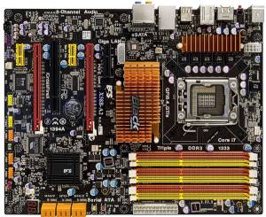

Hi there,
i have a ECS X58B-A2 mainboard thats had a bad BIOS flash, the board has an 8 pin SPI header, i am wandering if the GQ-4X will be able to program the SST25VF080B EEPROM on the board? also ifso.. what cables are required to do so.
thanks in advance.
Posted - 08/02/2009 : 06:59:55
The GQ-4X supports SST25VF080B EEPROM.
If your motherboard has SPI header, then it should be able to re-program it on board.
If you have jumper wires, then you may directly connect the motherboard SPI header to the programmer ZIF socket.

Posted - 08/11/2009 : 00:36:21
Programmer arrived today!! and the boards living once again.. the Programmer is Worth Every penny!!
BTW the EEPROM i had on the board was SST25VF016B.. little hard to see as the "16" was half scratched off.
Edited by - 3baby on 08/11/2009 01:54:35
Posted - 08/11/2009 : 10:07:48
MB picture:
ECS X58B-A2
