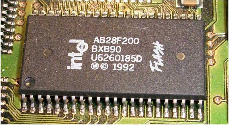

Hello I just got the GQ-X4 and I must say I'm very happy with it. I have a question though. Can it read and program the Intel AB28F200 flash EPROM?
I was looking into device support and there are some similar EPROMs but not this one. I will try to upload a picture of it.

Select PA28F200BX-B*PSOP44.

I got the adapter and using the setup by ZLM I had no problem reading, erasing and programming this chip.
