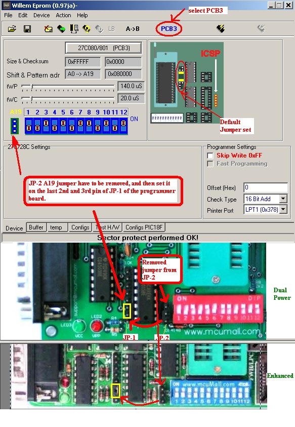

can't seem to properly read a 27c801 on this willem enchanced programmer. bought the programmer from here, the usb powered one.
any help would be appreciated.

Check all jumpers setting:
see:

Posted - 02/15/2006 : 17:26:45
thank you sooo much. all is working now. checksums match!
