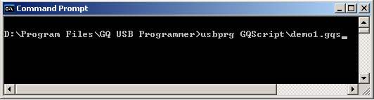

Red-58,
try 5.01Beta:
http://www.mcumall.com/download/TrueUSBWillem/GQUSBPrgRe5.01Beta.exe
This one should accept the command line start-up in windows CMD window with script command parameter.
*Example:
"C:\Program Files\GQ USB Programmer>usbprg GQScript\demo1.gqs"
This line will run the demo1.gqs script once the software started with out any error.
*The command line parameter will accept all GQScript commands.
Example:
"C:\Program Files\GQ USB Programmer>usbprg EXIT APP"
This line will exit the software just after start up the software.

I need to run a script from the command line as well. This link is broken and I don't see a version 5.01 Beta on the download page. May I *please* get a version that runs a script from the command line?
Red-58,
try 5.01Beta:
*Example:
Example:
11.7 KB
