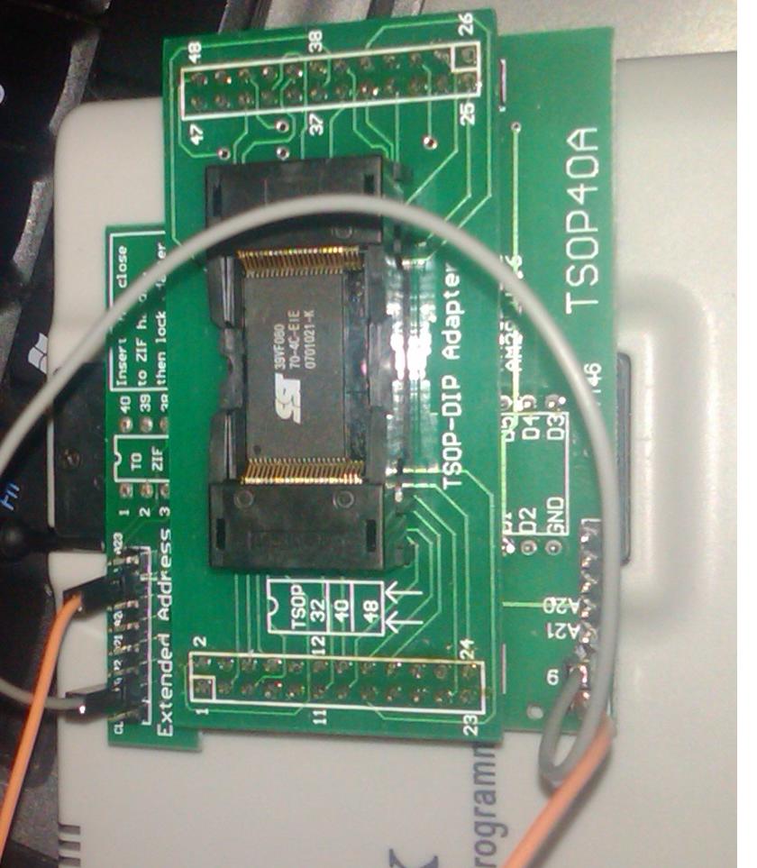

I just purchased a GQ-4X and cannot get my chip to ID.
I have checked the pins, I used the TSOP40A adapter plus the address header set to A19, no luck.
I have a TSOP48 holder, is that the issue?
When I ordered my set it told me that the TSOP48 works with TSOP40. If I cannot get the chip to ID then I cannot get it reflashed.

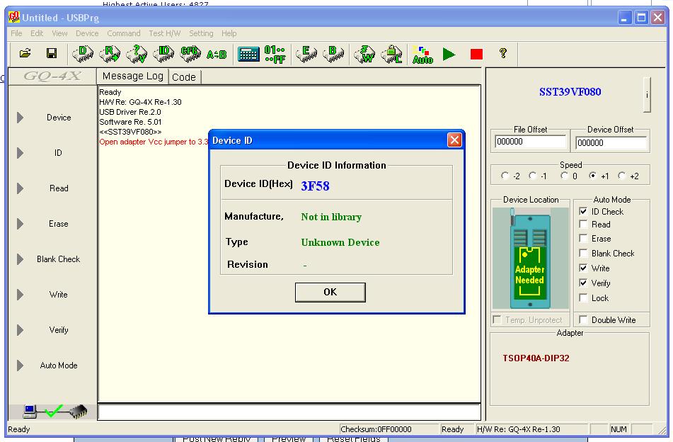

Support for this device is very poor. No need to say that the program works with this item. I keep getting 8 different IDs and not a single one is the one for this device. Poor, poor, poor.

The SST29VF080 is a verified chip on GQ-4X.
It seems you have a old version TSOP40A adapter. But that is not a big problem as long as you use a address header ADP-053.
The TSOP40A base baord comes with a TSOP48 ZIF socket board ADP-077.
If you can not get the correct ID, then you need to check the pin contacting, chip orientation and adapter contacting with programmer.
Use a magnify glass to check if all chip pins are well contacted with the ZIF socket.

Every time I check it I get a different ID. I have come up with 8 different IDs on 8 different chips that all read SST39VF080.
If I cannot get the ID, I cannot even start the process to get to a failure in the programming.
How can this be old style? I bought it in 02/2010 from MCUMall.com.
I used a magnifier from the start and checked the pins are clean of solder.
So where do I go from here?

Posted - 03/26/2010 :  11:08:24  Show Profile  Reply with Quote
The latest version adapter has build-in 74HC244 driver chip.
see: ADP-082
http://www.mcumall.com/comersus/store/comersus_viewItem.asp?idProduct=4418
Write email to support@mcumall.com, your adapter is still under warranty I think if you just bought it.
