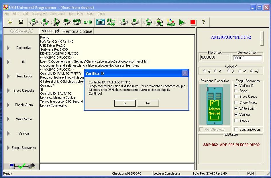

Hello,
I can not read with programmer GQ-4X an EPROM 29F010B I have this error:
What can I do?
108.73 KB
Posted - 08/25/2010 :  06:34:00  Show Profile  Reply with Quote
check:
1. chip pin contacting problem.
2. chip chip pin 1 location to make sure you have placed chip in correct orientation.
3. check the adapter has no soldering problem. It is best to use a multi-meter.
4. change to another chip.

Posted - 08/25/2010 :  06:39:42  Show Profile  Reply with Quote
check:
it's ok
it's ok
it's ok
with the first chip i've error "FFFF" with second chip error "8080"
Edited by - psxboxmod on 08/25/2010 06:40:57
Posted - 08/25/2010 :  08:00:12  Show Profile  Reply with Quote
Check adapter.
