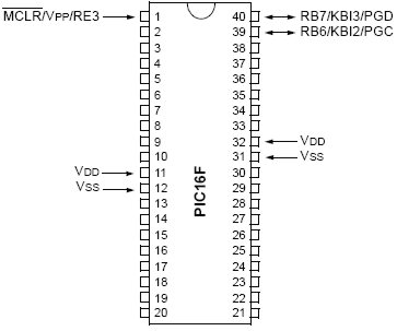

could you just do me another favor and give me the example for PIC16F747
i couldn't find where to hook up the data pin, and i prefer not to damage the programmer :)
Posted - 12/03/2010 :  20:34:11  Show Profile
18.9 KB
PGD = Data
PGC = CLK
