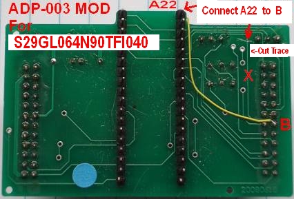

Posted - 01/24/2011 :  20:28:53  Show Profile  Reply with Quote
Based on the information from EZoSat, it should work with this adapter. The adpter has same circuit as the adapter used in EZosat testing. I can give you a picture on how to add the A22 on this ADP-003 adapter for S29GL064N90TFI040.

Posted - 02/24/2011 :  12:40:45  Show Profile  Reply with Quote
Tested on S29GL064N90TFI040 with a A22 connection. It can ID, read, write, verify, erase, blank check correctly.
Using this device line:
Name="S29GL064N90TFI040",ID="017E",Class="29LV320T",Category="FLASH",MFG="SPANSION",CodeSize="8388608",Adapter="ADP-003 With MOD",VCC="3.6V",Message="Set the adapter to 5V, 29F jumper position. Using ADP-003 MOD 01";
Bottom side look of ADP-003:
86.91 KB
