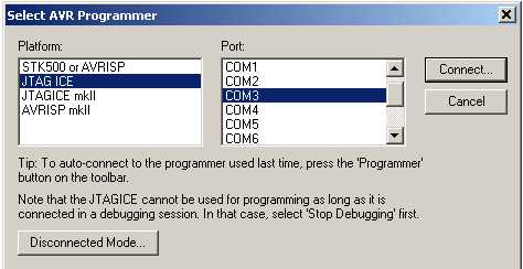

Here are steps for connect the device to the AVR Studio doing the ISP programming:
1. After connect the AVRISP/ICE, you should be able to see a virtual comport of CP120x device. From Windows device manager you will be able to see that COM port number. Remember that serial port number.
2. After you started the AVR Studio 4, load your project, and then goto menu "Tools-->Program AVR-->Connect", then you will be able to see the connection window this:
br]
18.73 KB
3.Selec the COM port number in the step 1 you remembered.

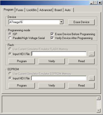

4.Click on "Connect..." button you should be able to see
29.63 KB
