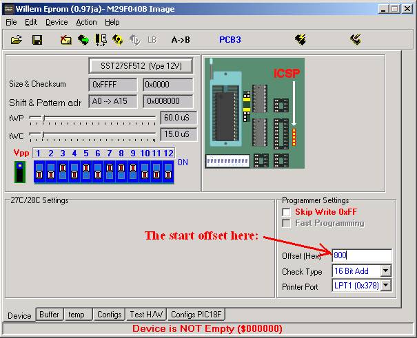

Hello folks,
I am a car tuner here in Colorado Springs.
I am currently dropping in a SST27SF512 in the place of a 27C256 chip. The site I bought the chip from says that to use the 27SF512 in place of a 27C256 that I must adjust the 'Start of Device' value when programming for 27C256 original, set to 8000 hex.
How do I do this on a Dual Power Willem Universal EPROM Programmer with the latest software version?
I did see how to adjust the jumper blocks for the proper read/write and then to erase, but curious how to change the start of device if possible.
Thanks much in advance!

Start Offset:
58.03 KB

BlueSky...if you are ever in Colorado Springs I owe you a beer/soda/water whatever your poison!
Thank you VERY much!
