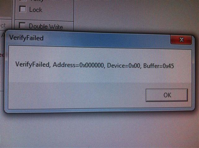

I have read this chip as 93C76B 16 bit, and i am trying to write new data but i get this error message in verifying process
Writing 100% and then verify failed!
What is the problem with this please?

Hi, i tried reading as both 8 bit and 16 bit, but the i got more clear dump with 16 bit, i modified the dump and i am trying to write but i get an error

i am working on another chip 93C56, and i get the same problem
i can read ok, but can't write on it, i get the same message shown above in the photo
i updated to latest software 6.14, try slowest speed -2 and the problem is still there, same !!
Any ideas please

Hi
The chip is 93C56 made by ST
Which chip should i select on the device list?
Maybe the problem is coming from the the device choice?

Try 93C56A. If it does not work, then try 93C56B.

Tried it, didn't work!
tried another chip from another device, same !
Will try to desolder the chip and do it on the programmer with the adapter and see what happens
