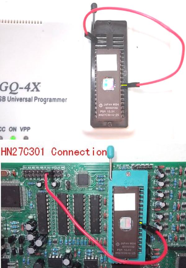

Im trying to burn a HN27C301 but when I select this chip in the device menu I get this message :
This chip needs a wire jumper from Address header A23 to ZIF Pin24
How do I do that, there is no address header 23 on a hn27c301?
Posted - 04/24/2012 : 21:52:04
See:
http://www.mcumall.com/support/27C301_Connection.jpg
