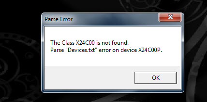

Uninstalled previous USBPrg, installed latest as admin (on Win7 64-bit system) now I get the error:
23.37 KB
What did I do wrong?

If you hear what this might be please share I will do same.. I updated today and this is same thing I got... About to throw mine in trash... Just not what I expected from a Programmer.. Thanks Jerry

I rolled back to the previous version. Supposedly you can edit the DEVICE.TXT file and remove that device...but think I'll wait until it's fixed properly before upgrading software.
