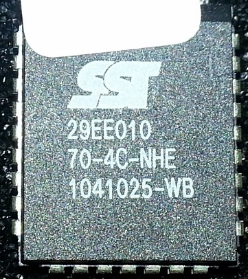

Just got my GQ-4X yesterday and have been having fun with it. Find it fairly straight forward. However, I need to read a "SST29EE010 PLCC32" but it only seems to support the TSOP and DIP packages. Am I overlooking something or can I import an updated file. See attached Pic.

Use ADP-0062 OR ADP-005, you can either select TSOP or DIP package device from software.
