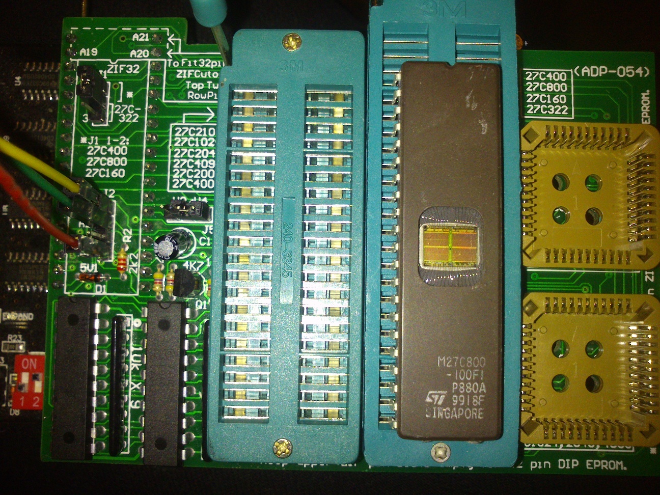

I'm using one of your adaptors:
h**p://www.jensma.de/upload/files/hW01Y6pL__DSC_0585.jpg
Recently the adapter behaves weird.
I want to put data like this on it:
AAA
BBB
CCC
DDD
EEE
FFF
My programmer ends up with an error. The eprom contains data like:
AAA
BBB
CCC
AAA
BBB
It kinda repeats the data at some point. The error pops up while writing a file to an 27C800 eprom, at adress 0x000202.
Any ideas what could be wrong?
Thanks in advance =)
Posted - 09/27/2013 :  12:36:17  Show Profile
Your have bad pin contacting on address pin.
The address is starting to repeat is the pin need to be checked.
