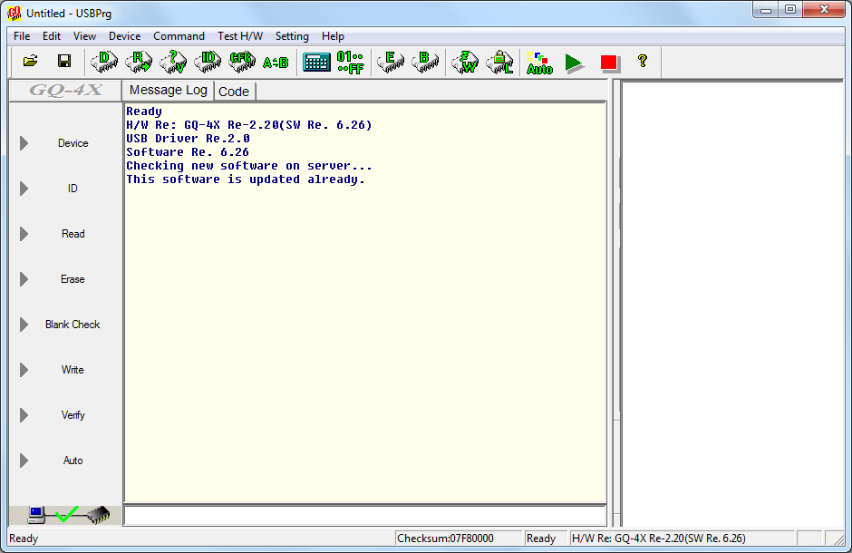

Hello, I just received my GQ-4X in the mail. I'm running Windows 7 Ultimate 64-bit, service pack 1. I installed the latest version of USBPrg (6.27) and ran into this problem.

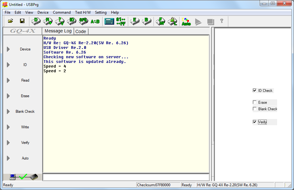

I seem to be encountering the same bug described in this post. USBPrg starts up fine and detects my GQ-4X, but the configuration panel on the right-hand side is completely obscured by what seems to be a text area that can't be typed in. Resizing the window or selecting a new device causes the window contents to briefly appear during the redraw, but then it's immediately covered again.
By moving the mouse cursor around in the window I can tell where some of the interactive controls are when hovering over them. Clicking causes the selected control to appear, but again, they all disappear when the whole window redraws.
You'll note in the screenshots that the previous version (6.26) is running; I attempted installing that (after uninstalling 6.27) after reading the suggestion in the other post, but the problem affects that version as well.
