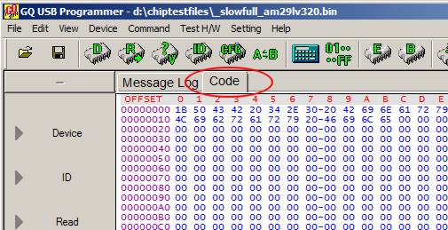

Is there a way to display the hex data? I can "read" the data into a buffer and now I want to display it so I can "see" the hex data info. I have an old UNIPRO programmer which allows me to do this, but do not find command for this GQ-4X that will do the same.
Mel
Posted - 02/28/2014 :  19:38:38  Show Profile
click on Code tab:
48.34 KB

Posted - 05/02/2014 :  18:17:20  Show Profile
click on Code tab:
48.34 KB
When I do this with ver 6.29, only FF are displayed. I'm trying to read from a KNOWN good PROM and software says it Reads values but only displays FF. In fact, software says it reads WITHOUT ANY CHIP in the GQ-4X programmer. Obviously, software is not reading properly. Why?
____________
Brian
Posted - 05/07/2014 :  10:01:48  Show Profile
Software does not check the chip. So, it read the empty ZIF.
