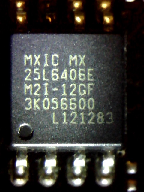

Hi,
I have a number of these Apple boards that have been scrapped for various reasons. To help I have taken a picture of the actual bios chip that is on a 820-3115 board.
88.34 KB
Laptronics UK LTd. Specialist motherboard repair.
Posted - 08/09/2015 :  22:38:52  Show Profile
This is supported.
See supported device list:
http://www.mcumall.com/comersus/store/mcumall_TrueUSBWillemsupportICs.asp
