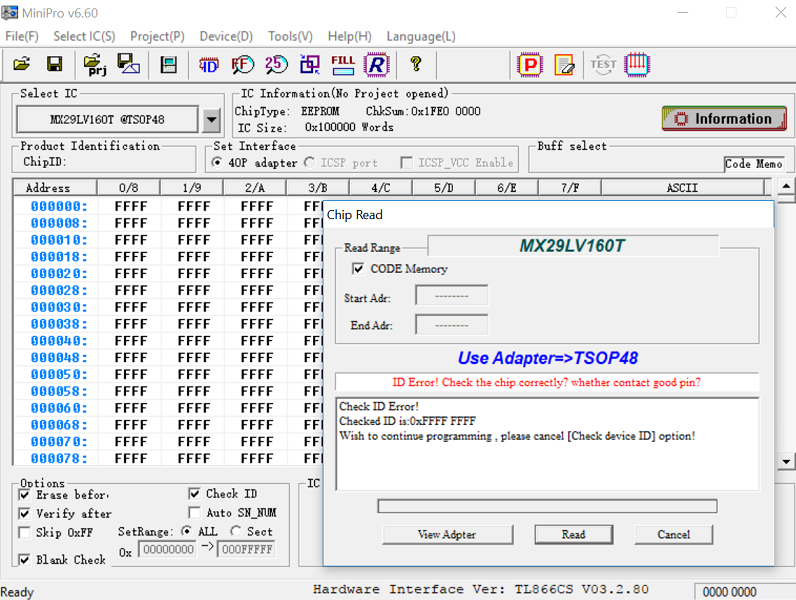

Hi, I'd like to check if anyone here has encountered issues to program a MX29LV160 and MX29F1610 with MiniPro TL866CS?
Drop down list from MiniPro Programmer Software does not include MX29LV160 SOP44 (only TSOP48) and does not include at any MX29F1610.
I've only been successful with burning MX29F800T so far.
Any advice on how to add the missing EEPROM to the list?

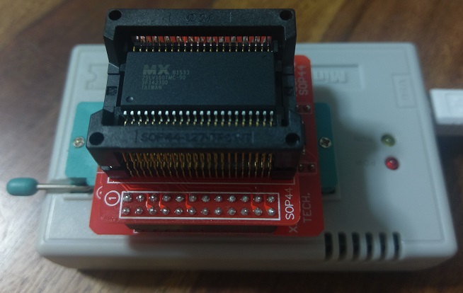

It can be program with a modified pin 9(A19)/11(WE)/12(Reset) on TSOP48 V.3 adapter along with SOP44 adapter.!! Also you need to select chip as "MX29LV160T @TSOP48" on MiniProv660.

Thanks for your reply, I am currently using both adapter TSOP48 V.3 and SOP44 but I do not quite understand what kind of modifications I should do on the 3 pins you mentioned.
The pins mentioned match with TSOP48 package while I need to use SOP44 package.
Can you please elaborate?
