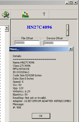

ZLM Posted - 06/20/2008 : 07:37:04
Makesure the device information(my previous post)is correct. Only 2.08Beta has this correct info.
Check the contacting of chip and adapter. untill it read correctly.

ZLM Posted - 06/19/2008 : 07:56:09
What is your hardware model? GQ-3X or GQ-2X?
The HN27C4096 is the tested chip with Re2.08Beta. Please confirm you have selected correct device type from the device list "HN27C4096".
Try use a 9V external power adapter see if any difference.
Try slow down the speed.
Also, check the device information as following picture:
