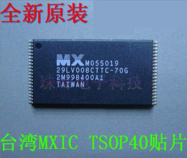

i have this mentioned mainboard and its without flash chip. i found out that its using 40 pin flash (TSOP40). i dont have such an adapter for my GQ-4X . Wich one adapter ( or adaper set ) should i use for it ?

ADP-082 with ADP-077
IF you already have other adapter with ADP-077, then you do not need the ADP-077.
But ADP-082 is needed.
