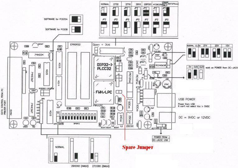

Those two aren't stated anywhere in the schematic. Also, on the board, above J12 is written "15 open 3.6V" and I found out that the Vcc pin (pin 32) of the zif is connected to the top left pin of the jumper. If I remove the top jumper, the power led becomes noticeably brighter and then I am finaly able to set the Vcc from Jumper 8, following the information of the jumper schematic! http://www.mcumall.com/support/StandardWillemUserGuide_files%5CPCB5.0JumpersLayout.jpg
I haven't noticed any voltage difference if I remove jumper 16 (which is mentioned as "spare jumper" in the last schematic), but I am not sure how it works. Will it cause any change whether it is placed or removed? [P.S. The Vcc pin of the zif is connected to the left pin of the jumper.]

1) Does anyone know what do those jumpers do?
https://imgur.com/a/wme0I
2) For some reason the ground of the board is not 0V, but ca. 0.6V. Is that a problem?
