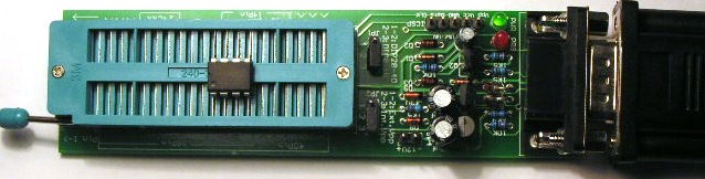

2. The green PWR LED should be light up.

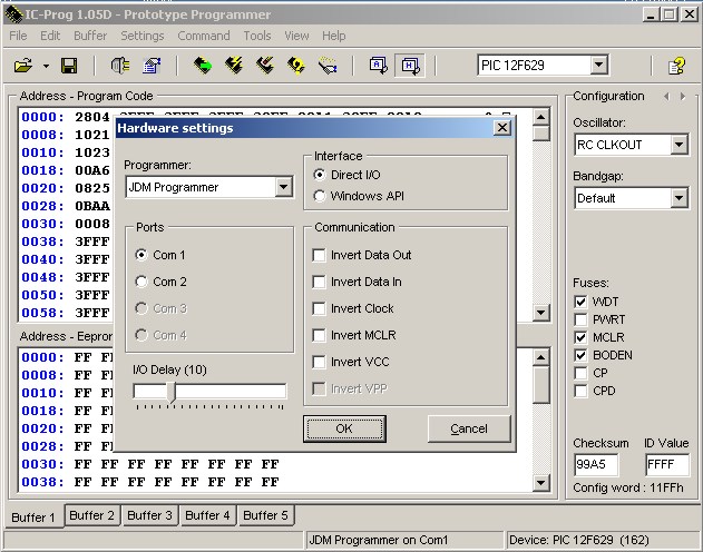

3. Start the software, eg. ICProg1.05D and select 12F629 as device in software.

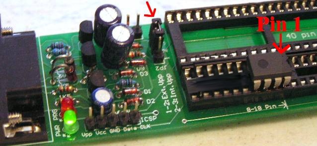

4. Make sure the JP1 is set on 2-3, and the JP2 is set on 2-3 too.
5. Place the 12F629 in the ZIF. Pin 1 toward the ZIF handle.
6. load the data into software
7. click on erase all button.
8. click on write all button.
Hardware Connection On ZIF version:
Hardware Connection On V2 version:
