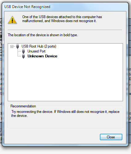

                Posted - 06/09/2010 : 03:52:18  Hi,
  I have a GQ-4X eprom programmer which I bought ~4-5 months ago from ebay user mcumall_electronics_inc. It worked fine until this morning, today I plugged it in to my pc and pc says that "USB Device Not Recognized"... I tried reinstall drivers and software, use another pc, different USB cable, but I get the same error message from pc... even USBprg software says "Did not get response from programmer. Demo only."
  Any help on that?

                Posted - 06/09/2010 : 08:53:51  The device is failing to enumerate itself to the system, so Windows doesn't know what driver to load. Dump from usbview:
  Device Descriptor: bcdUSB:             0x0000 bDeviceClass:         0x00 bDeviceSubClass:      0x00 bDeviceProtocol:      0x00 bMaxPacketSize0:      0x00 (0) idVendor:           0x0000 idProduct:          0x0000 bcdDevice:          0x0000 iManufacturer:        0x00 iProduct:             0x00 iSerialNumber:        0x00 bNumConfigurations:   0x00
  ConnectionStatus: DeviceFailedEnumeration Current Config Value: 0x00 Device Bus Speed:     Low Device Address:       0x00 Open Pipes:              0
  A typical device (in this case, an IBM mouse): Device Descriptor: bcdUSB:             0x0200 bDeviceClass:         0x00 bDeviceSubClass:      0x00 bDeviceProtocol:      0x00 bMaxPacketSize0:      0x08 (8) idVendor:           0x04B3 (IBM Corporation) idProduct:          0x310B bcdDevice:          0x0160 iManufacturer:        0x00 iProduct:             0x00 iSerialNumber:        0x00 bNumConfigurations:   0x01
  ConnectionStatus: DeviceConnected Current Config Value: 0x01 Device Bus Speed:     Low Device Address:       0x03 Open Pipes:              1
