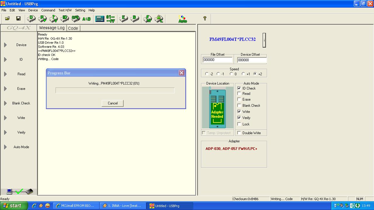

a have a problem ...when i try to write to winbond W39V040FB it hangs
read works ok ...erase work oki
same problem with sst49lf020 and pm49fl004t
any ideeas???

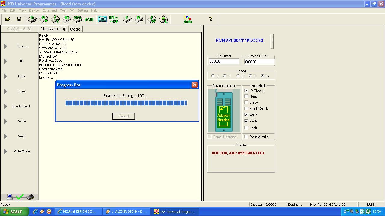

PLSSSS HELLLLLPPPPPPPPPPPPPPPPPPPPPPPPPPPP
98.24 KB
i m going crazy.......i change pmc49fl004t from an working motherboard...when i erase it remains at 100% and freeze
102.14 KB

Posted - 09/09/2009 :  08:47:37  Show Profile  Reply with Quote
The chip is not been erased correctly. The software is waiting for "Erased Successfully" signal from the chip, but the chip did not send that command.
There are some possibilities:
1. The chip is not contact well with the PLCC32 socket.
2. The chip is not a good chip. May be poor compatibility.
To find out why, we need a problem chip for testing. If possible, send the testing chip to support@mcumall.com. They will return it to your after testing.
