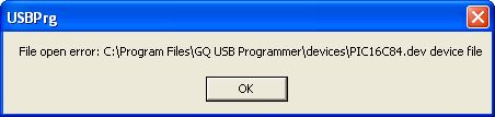

Anyway, I have added the line above into my devices.txt files and restarted USBPrg. PIC16C84 appeared in the list but once selected I got this error message :

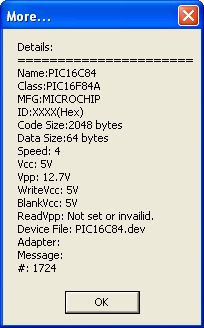

Of course this pic16c84.dev file doesn't exists. After pressing OK, I have got the default user interface with PIC16C84 device selected. I checked the device information by clicking on the small "i" button, and this gave me this :

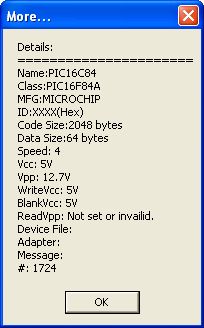

Definitively, something is wrong. The code and data sizes are incorrect. Voltages look OK.
I have created a new device file based on the PIC16F84A one and changed a few parameters. Now USBPrg doesn't complain about the missing file but parameters are still incorrect. What's wrong? Does USBPrg really reads parameters in the .dev file?
Here is my pic16c84.dev file:
