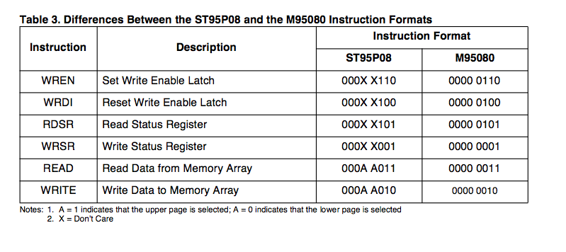

I tried a byte swap, I tried with 95080w/r (and swap byte),I tried as you said but no work, the car key is ok but car not start, if you look at the datasheet, you see that the two ICs are a bit different, you have to do a custom driver for 95080 only 8bit, with 16 byte page size, number of address bytes 1,the files written with 95080 must be identical read with 95p08,so sure that works well!!!

I think you can not use 95080 to replace the 95P08.
The READ instructions are different. That means the 95080 chip will not be read correctly in your car ECU.
