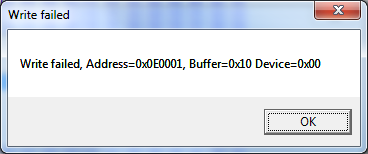

Hi there!
I just wanted to write the chip above, but I couldn't. If I select in Device W39V080APZ, it says I need an adapter. I have ADP-030, so I connected it to GQ-4X.
The prog warns me, it says: "<<W39V080APZ>>
Try to slowdown the speed when erasing if erase fail."
So, If speed is on +2, then erase will fail. If I slow down to +1 or 0, then everything goes well. But If I try to write it at speed +2, then at 88% I got an error message and the write lasts for 15 minutes.
25.93 KB
If I slow down to +1, it halts at 94% and it lasts a horribly long 8 HOURS, and stacks at 94%. I didn't try to write it at 0 speed, because I don't have time so much. What is the problem?!

Update1: if I set Device offset to 0E0000 and cut the original file to 0DFFFF regardless what speed I choose for the writing its nor working properly and the error message above pops up.

If the pogramming stopped someware more than 1 minitues, then somethng is wrong and you can close the software.
There are more than one factors may cause this problem:
1. adapter problem
2. pin contact
3. may be power related.
4. USB cable
